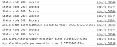

@Jay Kumar SenSharma
1st Point ambari-server.log : Error Processing URI: /api/v1/clusters/cluster-name/alerts - (java.lang.NullPointerException) null
2nd Incognito Browser- Console (Tab)
109333-1560168322710.png3rd There is enough memory for Ambari-Server to function approx 166GB is Available.
4th With the help of your link above there is no log in ambari server saying exceeded Java Heap Size.
The error in ambari-server is Java Null Pointer Exception null running alerts tab.
Please Suggest.

Super Mentor
@Rohit Sharma
Your recent error indicates that there is some inconsistency in your Ambari DB. Due to this inconsistency the Ambari UI for Alerts page is not showing any alert details.
You can follow the below article to get this issue fixed.
Please make sure to take a fresh Amabri DB dump for backup purpose before following the below article.
https://community.hortonworks.com/content/supportkb/174817/ambari-alert-page-is-invisible-on-ambari-...
After performing the steps mentioned in the above article please do not forget to restart Ambari Server.
