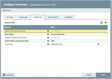

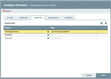

I have tried adjusting the UnpackContent settings and even have added an UpdateAttribute to add the application/zip mime type as well. Still keep getting the failure. I have also tried the CompressContent processor and still get these errors on simple WinZip files.

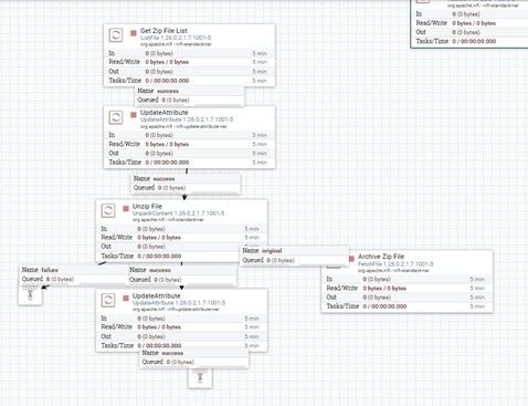

I am attaching my flow, my processor settings and error message.

ListFile only creates 0 byte (no content) FlowFiles that must be sent to a FetchFile processor to retrieve and add the content to the FlowFile.   The List<abcC> and Fetch<abc> type processors should be used instead of Get<abc> type processor when working In a multi-node NiFi cluster setup.    These processor allow you to run list<abc> on primary node only, load-balance the listed FlowFiles across all nodes in the NIFi cluster, and then fetch<abc> the content. Spread the workload across the cluster for ingest types that don't support cluster setups (ListFile, ListSFTP, ListFTP, etc).
TIP:
Your attached image was so small I could not read the processor types.  When you add an image to a new post you can click on it and expand it size to make it larger by dragging form the corner of the image before hitting "Reply".

I figured it out. It was not so much the UnpackContent processor, but how I was bringing in the flowfile itself. I was using ListFile and passing to the UnpackContent processor. I switched to a GetFile processor with a File Filter of .*\.zip and the unzip worked perfectly. So looks like I will need to get the file with GetFile, unzip, and archive the file with PutFile.
