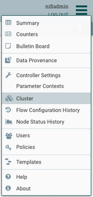

    1. Go to NIFi global menu in upper right corner of UI of node that is still connected to cluster and selected "cluster":
    2. From the new UI you will see a list of your nodes. To the left of nodes you will see a small "view details" icon.  Click on that for one of the nodes that experienced a disconnection (It might currently be connected).  This will open a new UI that will contain node events.  Node disconnections and reconnection with reason will be provided here.
