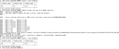

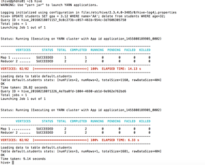

@soumyabrata kole Update worked using beeline
Master Mentor
@soumyabrata kole It's working though beeline @soumyabrata kole
