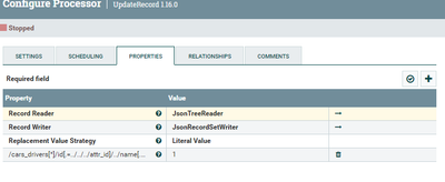

2 - UpdateRecord Processor: Once the attributes are added to the Json , you can update those records Is_processed value only when the id matches the attr_id and name matches the attr_name. To do that set the following properties:
     a- Replacement Value Strategy: Literal Value
     b- /cars_drivers[*]/id[.=../../../attr_id]/../name[.=../../../attr_name]/../is_processed : 1
