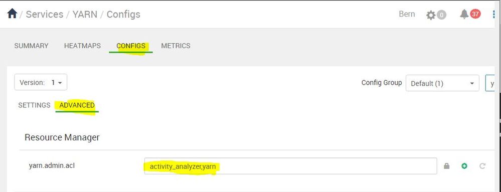

Master Mentor
@Sayed016
Can you compare the values of the yarn.admin.acl in the yarn-site.xml of both clusters? In my cluster its activity_analyzer, yarn this is a comma-delimited value so now you can add the user who is not allowed in your case and restart the stale config and revert.
Your user should now be able to access the logs
Happy hadooping
Master Collaborator
@Sayed016 I can see there is no "," after Yarn username, Can you try adding"," after yarn user name as shown below
yarn.admin.acl=dr.who,user1,yarn,admingroup2
Master Mentor
@Scharan
As it's supposed a comma delimited user list YES and that and restart the config a nd let me know.
Master Mentor
@Scharan
Surely and any user you want to access the Yarn UI . the only condition it should be comma-delimited.
Please do that are restart  the stale service and revert
Contributor
Hello @Scharan and @Shelton
Thank you for the reply. Please note that there are groups too and the group name should be separated from the user name with space or else all will be treated as users. Source: https://docs.cloudera.com/cdp-private-cloud-base/7.1.6/yarn-security/topics/yarn-admin-acl.html
