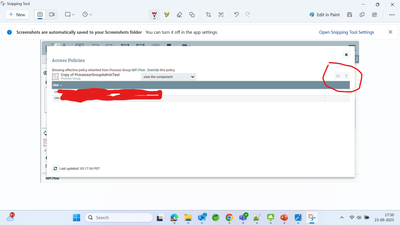

I saw in some article that we need to right click on certain processor group and then go to "Manage Access Policies" but surprisingly for my admin account the Add User icon is gray and not able to click it. I have added two photos one showing my user component toolbar being inaccessible and another one my admin cert logged in NiFi where I see Add User icon not accessible.(Note I can add user from Global Menu)

Form the second image you shared we can see that you have access the "policies" for a child process group named "Copy of ProcessGroupAdminTest".
What we can also see from this is that it is inheriting the "view the component" policy from the root process group "NiFi Flow":
This is why you will see the add user and delete options as greyed out.  You need to first click "override" and choose either to start with no users or copy the current authorized users.  After doing this you will be able to add additional user to this policy on this child process group.
Keep in mind that once you override inheritance on this components policy(s), inheritance no longer applies to this component.  Any changes to the policies set on the parent Process Group "NiFi Flow" will not get applied to this child Process Group.

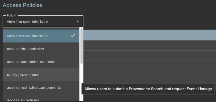

NiFi has "Global Access Policies" and "Component Access Policies"
The Global Access Policies are set by accessing the NiFi Global menu (three horizontal lines in upper right corner of the NiFi UI) and then "Policies".
If you hover your cursor over the access policy, it will pop-up a description of what the policy grants access for:
The levels of access you want to provide your individual users/teams is completely up to you.  ALL users must be authorized for the "View the User Interface" global access policy in order to access the NiFi UI, but that does not give the user much access beyond that.

When you authorize a user to "View Provenance", you are authorizing that user to be able to view provenance events created by that component (and any components that may be inheriting this authorization).   So this authorizations controls what the user can see, but does not give that user the ability to execute a provenance query. For that the admin user will need to go into the NiFi Global menu --> Policies and authorize the user for "query provenance" access policy.
