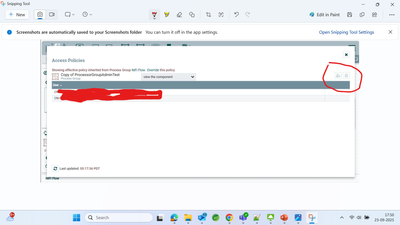

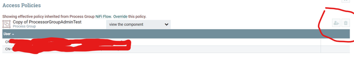

I saw in some article that we need to right click on certain processor group and then go to "Manage Access Policies" but surprisingly for my admin account the Add User icon is gray and not able to click it. I have added two photos one showing my user component toolbar being inaccessible and another one my admin cert logged in NiFi where I see Add User icon not accessible.(Note I can add user from Global Menu)

Form the second image you shared we can see that you have access the "policies" for a child process group named "Copy of ProcessGroupAdminTest".
What we can also see from this is that it is inheriting the "view the component" policy from the root process group "NiFi Flow":
This is why you will see the add user and delete options as greyed out.  You need to first click "override" and choose either to start with no users or copy the current authorized users.  After doing this you will be able to add additional user to this policy on this child process group.
Keep in mind that once you override inheritance on this components policy(s), inheritance no longer applies to this component.  Any changes to the policies set on the parent Process Group "NiFi Flow" will not get applied to this child Process Group.

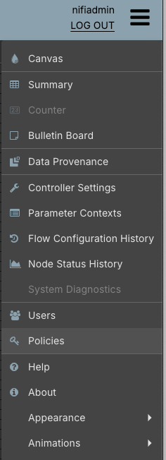

The Global Access Policies are set by accessing the NiFi Global menu (three horizontal lines in upper right corner of the NiFi UI) and then "Policies".

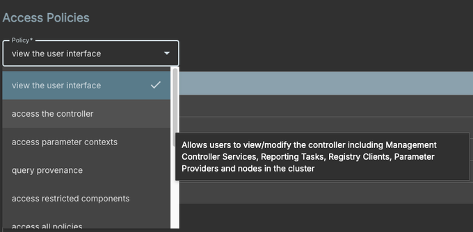

If you hover your cursor over the access policy, it will pop-up a description of what the policy grants access for:
The levels of access you want to provide your individual users/teams is completely up to you.  ALL users must be authorized for the "View the User Interface" global access policy in order to access the NiFi UI, but that does not give the user much access beyond that.

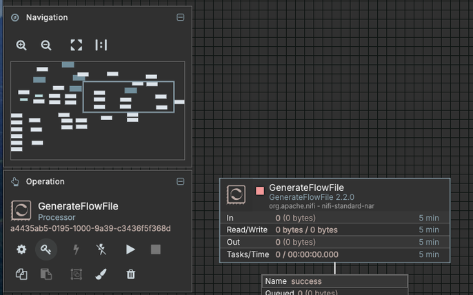

The component level access policies are set by clicking on the "key" icon for a selected component.  For example: Below I have clicked on the "GenerateFlowFile" processor as we can see it in the "operation" panel to its left.  Inside that Operate panel, your admin user (or other users you have authorized) will have access to the policies for that component.

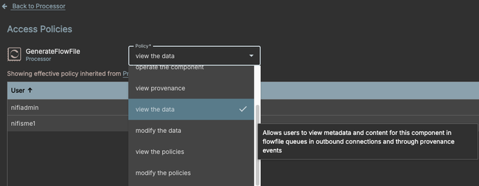

Rising Star
