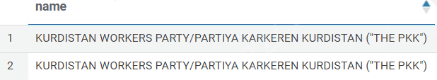

the hue shows:
and i try to export data to dat format by using impala-shell.

I want :   KURDISTAN ("THE PKK")
NOT:"KURDISTAN (""THE PKK"")"
