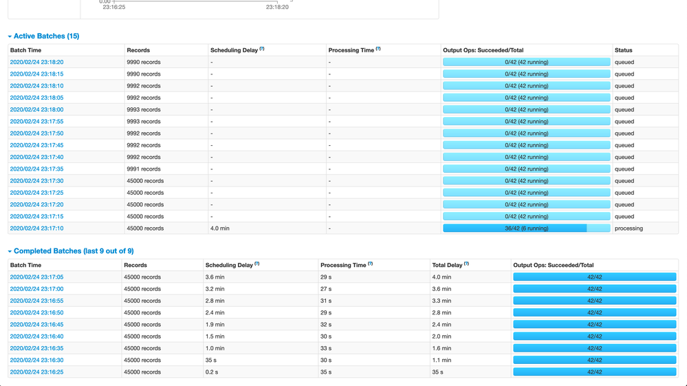

  batch.duration: 5
  spark.streaming.backpressure.pid.minRate: 2000
so, by configuration it starts with = 15 (total Number of partitions) X 600 (maxRatePerPartition) X 5 (batch Duration) = 45000 but it doesn't able to process these many records in 5 seconds. It drops to ~10,000  = 2000 (pid.minRate) X 5 (batch duration)
So, it spark.streaming.backpressure.pid.minRate is total records per seconds.
