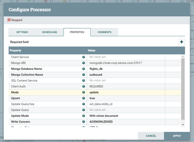

My current PutMongo (non-working attempt) configuration is this:

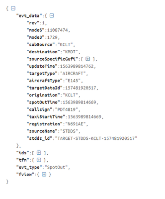

I'm trying to put a record that is keyed on the evt_data.stdds_id value as see in the following flowfile JSON:
In other words the key for the document in Mongo would be
"TARGET-STDDS-KCLT-157481920517"
This doesnt work, and I end up seeing multiple documents in mongo for that same key. I should only see one per distinct key.
What is the proper way to set the update key?

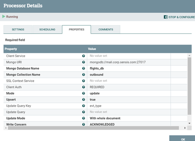

I've verified that if the key is set to a field that is in the root level of my JSON then I am able to update/upsert properly.
For example, I tried this with the evt_type field:
This worked fine. So my only question is how do I handle a field that is one level down in the JSON

{"evt_data": {"stdds_id": "stdds_id_value" , ...}}
