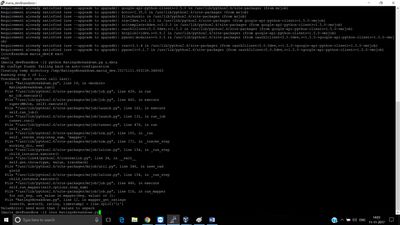

When i try to run the RatingsBreakdown.py code, i found this error please rectify this error
When i try to run RatingsBreakdown.py i found this error, please rectify the error formed

@Karthick Raja,
Check this line in your code
RatingsBreakdown.py line 12, in mapper_get_ratings
(userID, movieID, rating, timestamp ) = line.split('\t')
The line should have exactly 4 values else you may get the issue 'ValueError: need more than 2 values to unpack' . Check the input or add a validation
if len(line.split('\t')) == 4:

please reply community, i need your help
Super Guru
@Karthick Raja,
