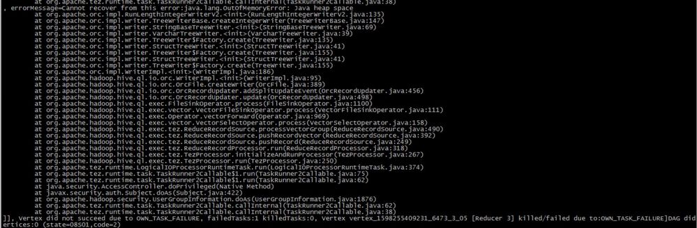

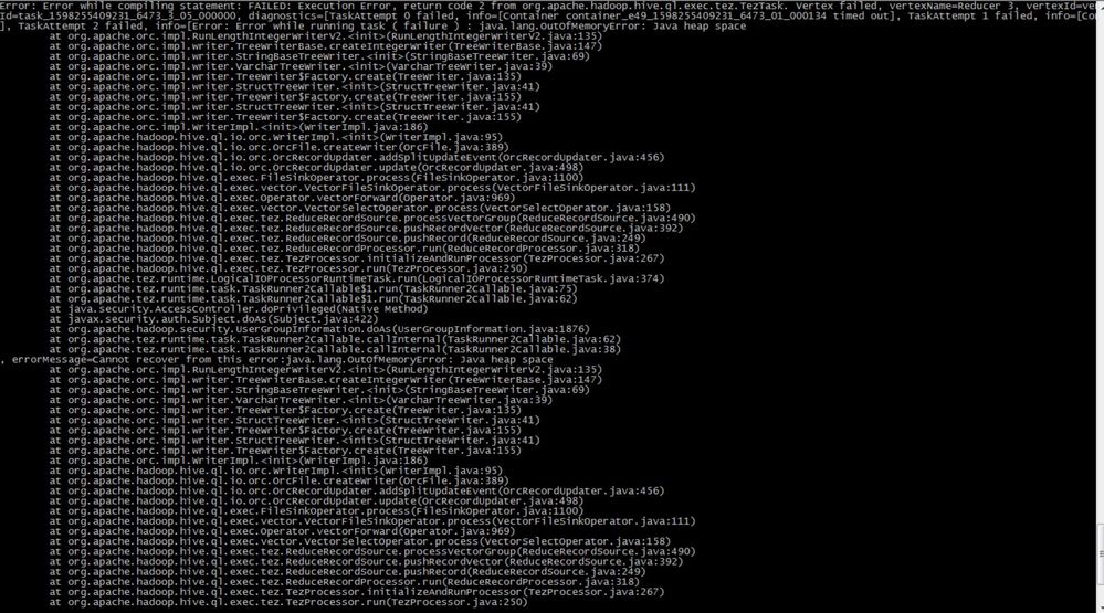

When using hive sql,it indicates the task failed(show in pic 1 and 2).However, when entering YARN to see applications, it shows the task succeed(pic 3), can anybody explain it?Please

Sincerely,thanks to the reply.I would like to offer more information you may need. We use cdp7.1.1. The successful information can be seen in YARN(MR included), which is in cloudera manager.
