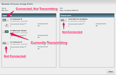

  1. Which compression algorithm is used when a remote port communication is set up?
  2. Can it be customized?
  3. Does it work on a FlowFile level or the batch that s2s protocol negotiated for transmission?
