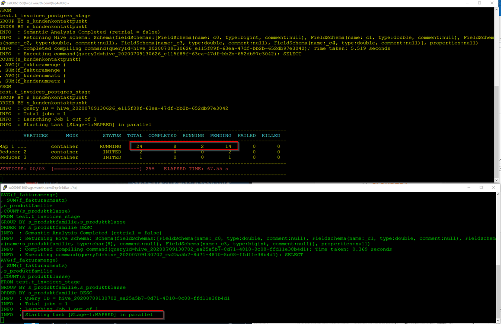

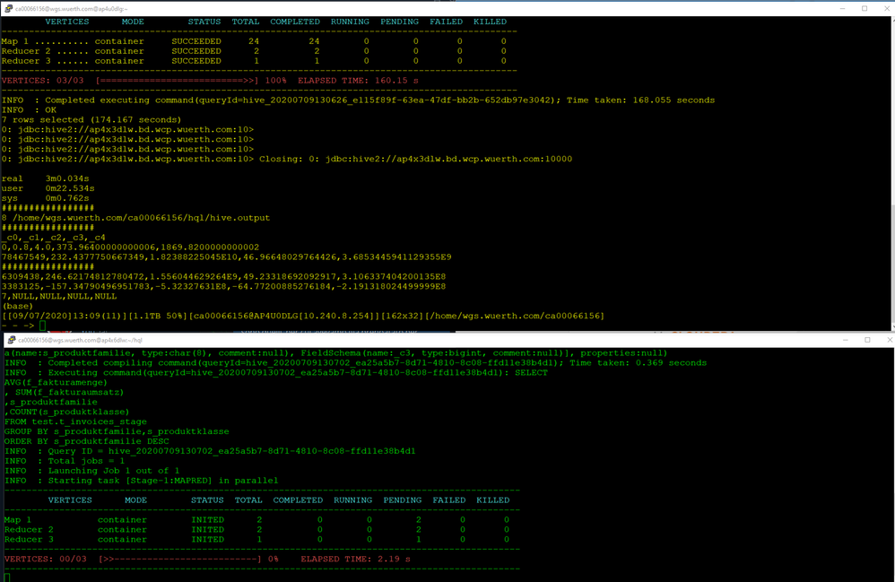

000809_20200709_130929_WN00066156@CN2911IT002481.pngyes, here is the screenshot:
query 1 (green) is started and query 2 (yellow) waits until all the jobs of query one are done

I have checked the screenshot. This is not application concurrency. Reducer phases1 is waiting for all the mappers to get finished.  DAG is  decided by the optimizer.
