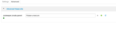

'/hbase-unsecure' is just the default ZooKeeper parent node created by Ambari when running without Security (Kerberos enabled). If you want to change this value, you can do so by the Ambari configuration UI for HBase and then restart HBase.

When I use a client talend studio , I must specified /hbase-unsecure. What the best pratice , i must redefine
zookeeper.znode.parent in the file hbase-site.xml. I want to create a database for production
thanks
