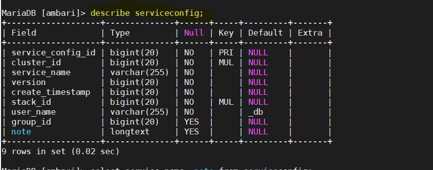

I zeroed on the serviceconfig table
MariaDB [ambari]> describe serviceconfig;

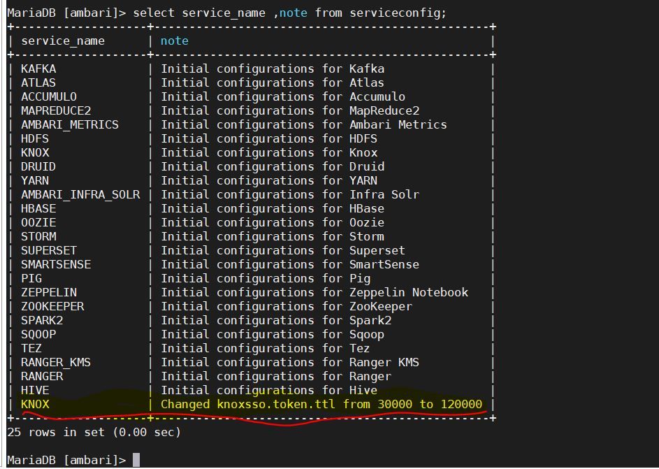

From the output, I easily chose my rows
MariaDB [ambari]> select service_name ,user_name,note from serviceconfig;

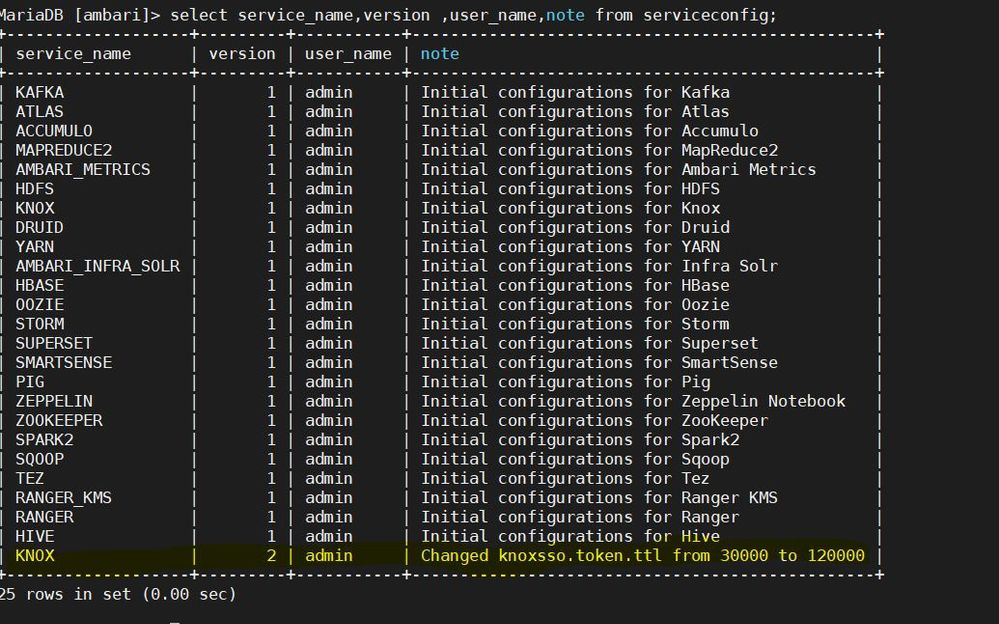

002.JPGI then added a filter to grab the version and note to validate it against my Ambari UI
MariaDB [ambari]> select service_name,version ,user_name,note from serviceconfig;
So here is the Ambari UI screenshot
Voila the confirmation that changes doe in Ambari UI is persisted to whatever backend database is plugged Ambari.
