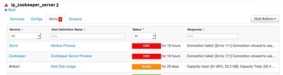

I have 4 machines in the cluster (1 master 3 slaves)
Zookeeper server is installed in the master (works fine) and in one slave (fails)
This is the log I get from the slave
zookeeperLOG.txt
New Member
Thanks @Geoffrey Shelton Okot for your help!
I did restart all services manually but seems that ZK still fails. From the screenshot I posted, one of my ZK servers is always down. Since ZK needs to be up and running before anything else, I'd like to fix this issue before anything else. I checked the error message from Ambari and it says
The error message says
Connection failed: [Errno 111] Connection refused to ip_zookeeper_server2:2181
What else can I do to fix this?
