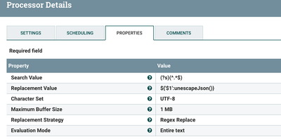

@Raj Negi
After FetchHbaseRow processor use ReplaceText processor with below configs:
Search Value
(?s)(^.*$)
Replacement Value
${'$1':unescapeJson()}
//capture all the data and apply nifi expression language unescapeJson function.
Character Set
UTF-8
Maximum Buffer Size
1 MB //change as per your flowfile size
Replacement Strategy
Regex Replace
Evaluation Mode
Entire text
Flow:
1.FetchHbaseRow
2.ReplaceText
--other processors

New Member
Thanks @Shu.
But this does not solve my problem. It does remove the \ from the json but the response is still not in the json response.
{"someValue":"[{"id":"6f7f8ffe-4837-4fc1-a5b9-45bc35727b69","name":"da_st","doc":"unknown","pnId":"2846e8e1-5b17-490c-a99e-df1f1e3fa009","status":"Approved","scope":"Global","dateModified":"2019-04-19T11:26:02Z"},{"id":"3559741f-76f6-4fb4-b919-6def5e0511fe","name":"Het","doc":"unknown","pnId":"2846e8e1-5b17-490c-a99e-df1f1e3fa009","status":"Approved","scope":"Global","dateModified":"2019-04-19T11:26:00Z"},{"id":"3b66fbda-9a16-48ac-9fd0-122e3826ef80","name":"queue","doc":"unknown","pnId":"2846e8e1-5b17-490c-a99e-df1f1e3fa009","status":"Approved","scope":"Global","dateModified":"2019-04-19T11:26:01Z"}]"}
The response should have been :
{"someValue":[{"id":"6f7f8ffe-4837-4fc1-a5b9-45bc35727b69","name":"da_st","doc":"unknown","pnId":"2846e8e1-5b17-490c-a99e-df1f1e3fa009","status":"Approved","scope":"Global","dateModified":"2019-04-19T11:26:02Z"},{"id":"3559741f-76f6-4fb4-b919-6def5e0511fe","name":"Het","doc":"unknown","pnId":"2846e8e1-5b17-490c-a99e-df1f1e3fa009","status":"Approved","scope":"Global","dateModified":"2019-04-19T11:26:00Z"},{"id":"3b66fbda-9a16-48ac-9fd0-122e3826ef80","name":"queue","doc":"unknown","pnId":"2846e8e1-5b17-490c-a99e-df1f1e3fa009","status":"Approved","scope":"Global","dateModified":"2019-04-19T11:26:01Z"}]}
The quotes should not be present before and after the array brackets([]).
Master Guru
@Raj Negi
Use nifi expression language to replace function to replace "[ and ]" with [ and ]
${'$1':unescapeJson():replace('"[','['):replace(']"',']')}
New Member
Thanks @Shu
I had done the same in my case with some minor modifications.
