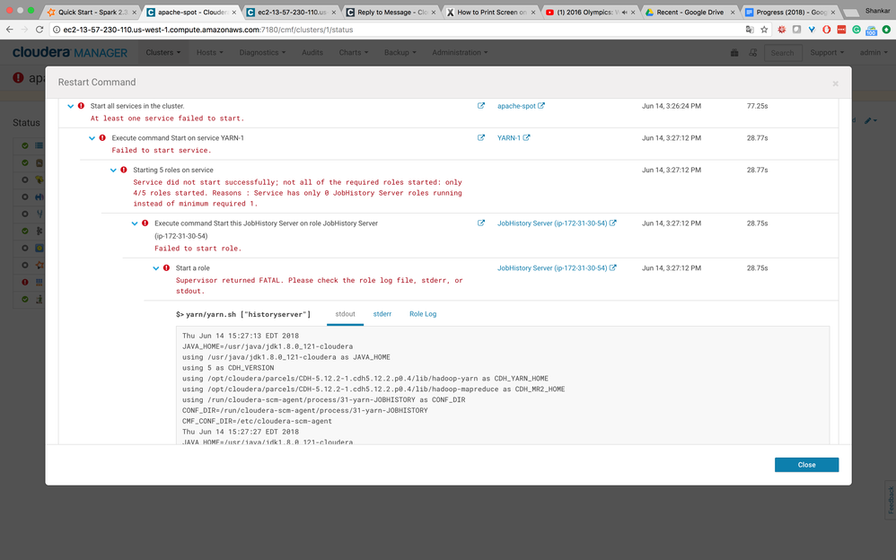

I logged into the CM UI and tried to start the cluster again (to diagnose what was wrong). It appears that the job history (of service YARN-1) failed to start. Attaching a snapshot.
In the role file, I see this message -
Service org.apache.hadoop.mapreduce.v2.hs.HistoryFileManager failed in state INITED; cause: org.apache.hadoop.yarn.exceptions.YarnRuntimeException: Error creating done directory: [hdfs://ip-172-31-30-54.us-west-1.compute.internal:8020/user/history/done]
	at org.apache.hadoop.mapreduce.v2.hs.HistoryFileManager.tryCreatingHistoryDirs(HistoryFileManager.java:682)
	at org.apache.hadoop.mapreduce.v2.hs.HistoryFileManager.createHistoryDirs(HistoryFileManager.java:618)
	at org.apache.hadoop.mapreduce.v2.hs.HistoryFileManager.serviceInit(HistoryFileManager.java:579)
	at org.apache.hadoop.service.AbstractService.init(AbstractService.java:163)
	at org.apache.hadoop.mapreduce.v2.hs.JobHistory.serviceInit(JobHistory.java:95)
	at org.apache.hadoop.service.CompositeService.serviceInit(CompositeService.java:107)
	at org.apache.hadoop.mapreduce.v2.hs.JobHistoryServer.serviceInit(JobHistoryServer.java:154)
	at org.apache.hadoop.mapreduce.v2.hs.JobHistoryServer.launchJobHistoryServer(JobHistoryServer.java:229)
	at org.apache.hadoop.mapreduce.v2.hs.JobHistoryServer.main(JobHistoryServer.java:239)
Caused by: org.apache.hadoop.security.AccessControlException: Permission denied: user=mapred, access=WRITE, inode="/":hdfs:supergroup:drwxr-xr-x

Any recommendations on how to debug further?
Thanks
Expert Contributor
sg321,
Please look at this article.
http://community.cloudera.com/t5/CDH-Manual-Installation/How-to-resolve-quot-Permission-denied-quot-...
I find it strange that you are getting this error on a clean cluster bootstrap. Can you share your conf file? Please redact any secrets (e.g., aws keys). What version of Director are you using?
David

Expert Contributor
sg321,
I've followed the instructions you linked through cluster bootstrap and successfully created a cluster using ami-2051294a in us-east-1.
I did have to make 1 modification to get the spark2 csd to match the spark2 parcel repo. You can do this by either bumping the csd up to http://archive.cloudera.com/spark2/csd/SPARK2_ON_YARN-2.2.0.cloudera2.jar or pinning the parcel repo to http://archive.cloudera.com/spark2/parcels/2.2.0.cloudera2/
Is this reliably/repeatably failing first run for you?
Explorer
This finally worked for me.
I have no idea why the YARN job history server failed to come. After adding permissions for "mapred" (described earlier in the forums), I was able to get the YARN service up. After that, spark installation failed.
After following your recommendation and updating the spark parcels in the director .conf file, the cluster came up successfully. I still have no idea how upgrading the spark versions prevented yarn from failing!
Thanks!
