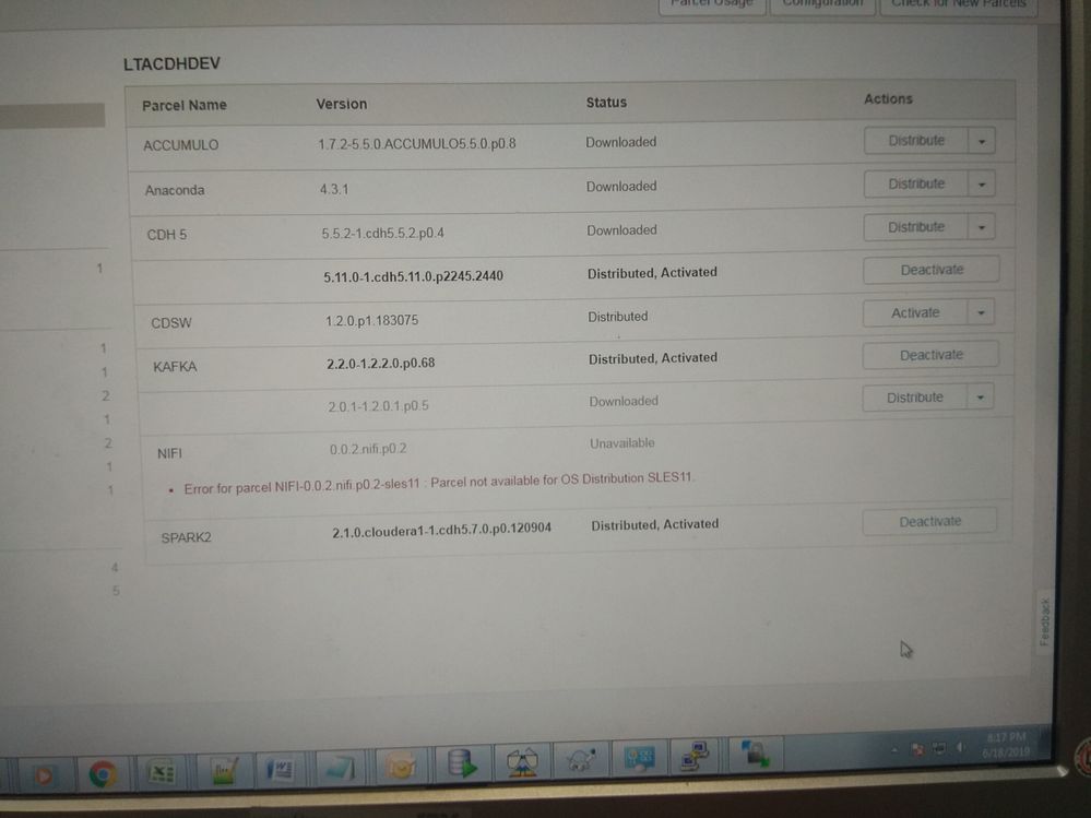

I realized that there is previous attempt to install Nifi parcel 0.0.2.nifi.p0.2 and having below error:
Error for parcel NIFI-0.0.2 nifi.p0.2-sles11 : Parcel not available for OS distribution SLES 11
Not sure if the above error is the reason causing my cloudera can't detect any new parcels from local parcel repository?

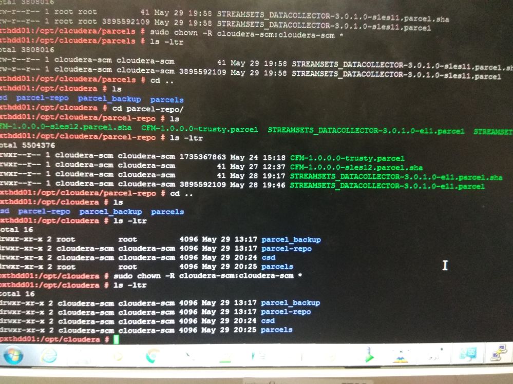

I have ensure sufficient privilege in both the parcels and parcel-repo folder by running "sudo chown -R cloudera-scm:cloudera-scm *"
Have tried to setup a Remote Parcel Repository for Cloudera Manager as well, those parcels place under the remote parcel repository also can't be detected.
Apache NiFi is comes under with a different Cloudera product named Cloudera Data Flow which needs a standalone subscription for this product.
You can refer some introductory document for more information.
http://vision.cloudera.com/cloudera-dataflow/
https://docs.hortonworks.com/HDPDocuments/CFM/CFM-1.0.0/installation/content/cfm-system-requirements...
So try to delete that NiFi parcel from the configuration and then try again.

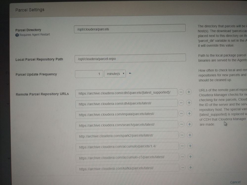

Attached below screenshoot of my configuration, folder permission, and the parcels to be installed:
My parcel directory and local parcel repository location
parcel configurationparcel configuration

Permission and ownership of the parcel directory:

Permission does not looks corrcet for me. Also the parcel-cache dir is missing here. In my lab it looks like this
[root@hostname cloudera]# ll
total 12
drwxr-xr-x 2 cloudera-scm cloudera-scm   56 Jun 17 23:14 csd
drwxr-xr-x 2 root         root         4096 Jun 17 23:24 parcel-cache
drwxr-xr-x 2 cloudera-scm cloudera-scm 4096 Jun 17 23:24 parcel-repo
drwxr-xr-x 7 root         root         4096 Jun 18 02:00 parcels
[root@hostname cloudera]# ls -lrt parcels/
total 0
drwxr-xr-x  8 root root  69 Oct 10  2016 ACCUMULO-1.7.2-5.5.0.ACCUMULO5.5.0.p0.8
drwxr-xr-x  6 root root  47 Nov 12  2018 KAFKA-3.1.1-1.3.1.1.p0.2
drwxr-xr-x 11 root root 110 Feb  8 10:24 CDH-5.15.3-1.cdh5.15.3.p0.94
drwxr-xr-x  6 root root  47 Jun 12 23:12 SPARK2-2.3.0.cloudera5-1.cdh5.13.3.p0.1178198
lrwxrwxrwx  1 root root  45 Jun 18 02:00 SPARK2 -> SPARK2-2.3.0.cloudera5-1.cdh5.13.3.p0.1178198
lrwxrwxrwx  1 root root  28 Jun 18 02:00 CDH -> CDH-5.15.3-1.cdh5.15.3.p0.94
lrwxrwxrwx  1 root root  39 Jun 18 02:00 ACCUMULO -> ACCUMULO-1.7.2-5.5.0.ACCUMULO5.5.0.p0.8
lrwxrwxrwx  1 root root  24 Jun 18 02:00 KAFKA -> KAFKA-3.1.1-1.3.1.1.p0.2
Then inside these the high level view is like below:
./parcel-cache:
total 96K
-rw-r--r-- 1 root root  794 Jun 17 23:24 ACCUMULO-1.7.2-5.5.0.ACCUMULO5.5.0.p0.8-el7.parcel.torrent
-rw-r--r-- 1 root root 7.4K Jun 17 23:23 SPARK2-2.3.0.cloudera5-1.cdh5.13.3.p0.1178198-el7.parcel.torrent
-rw-r--r-- 1 root root 2.9K Jun 17 23:22 KAFKA-3.1.1-1.3.1.1.p0.2-el7.parcel.torrent
-rw-r--r-- 1 root root  80K Jun 17 23:18 CDH-5.15.3-1.cdh5.15.3.p0.94-el7.parcel.torrent
./parcel-repo:
total 2.3G
-rw-r----- 1 cloudera-scm cloudera-scm  794 Jun 17 23:24 ACCUMULO-1.7.2-5.5.0.ACCUMULO5.5.0.p0.8-el7.parcel.torrent
-rw-r----- 1 cloudera-scm cloudera-scm   41 Jun 17 23:24 ACCUMULO-1.7.2-5.5.0.ACCUMULO5.5.0.p0.8-el7.parcel.sha
-rw-r----- 1 cloudera-scm cloudera-scm  16M Jun 17 23:24 ACCUMULO-1.7.2-5.5.0.ACCUMULO5.5.0.p0.8-el7.parcel
-rw-r----- 1 cloudera-scm cloudera-scm 7.4K Jun 17 23:23 SPARK2-2.3.0.cloudera5-1.cdh5.13.3.p0.1178198-el7.parcel.torrent
-rw-r----- 1 cloudera-scm cloudera-scm   41 Jun 17 23:23 SPARK2-2.3.0.cloudera5-1.cdh5.13.3.p0.1178198-el7.parcel.sha
-rw-r----- 1 cloudera-scm cloudera-scm 184M Jun 17 23:23 SPARK2-2.3.0.cloudera5-1.cdh5.13.3.p0.1178198-el7.parcel
-rw-r----- 1 cloudera-scm cloudera-scm 2.9K Jun 17 23:22 KAFKA-3.1.1-1.3.1.1.p0.2-el7.parcel.torrent
-rw-r----- 1 cloudera-scm cloudera-scm   41 Jun 17 23:22 KAFKA-3.1.1-1.3.1.1.p0.2-el7.parcel.sha
-rw-r----- 1 cloudera-scm cloudera-scm  70M Jun 17 23:22 KAFKA-3.1.1-1.3.1.1.p0.2-el7.parcel
-rw-r----- 1 cloudera-scm cloudera-scm  80K Jun 17 23:18 CDH-5.15.3-1.cdh5.15.3.p0.94-el7.parcel.torrent
-rw-r----- 1 cloudera-scm cloudera-scm   41 Jun 17 23:18 CDH-5.15.3-1.cdh5.15.3.p0.94-el7.parcel.sha
-rw-r----- 1 cloudera-scm cloudera-scm 2.0G Jun 17 23:18 CDH-5.15.3-1.cdh5.15.3.p0.94-el7.parcel
./csd:
total 20K
-rw-r--r-- 1 cloudera-scm cloudera-scm 19K Jun 17 23:14 SPARK2_ON_YARN-2.3.0.cloudera5-SNAPSHOT.jar
Please compare this and in needed follow the doc I have provided earlier to set the repo corrcetly.

New Contributor
Hi GangWar,
I realized that both my Development and Production Environment don't have the parcel-cache directory at all. Furthermore, there is nothing in the parcel-repo except the 2 parcels [streamsets, CDF] to be installed.
How do I recover the parcel cache directory?
Any other logs which I can look into to trouble shoot this issue?
Thanks
