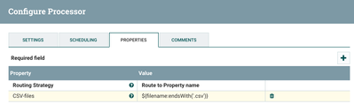

Assuming all your csv files have a csv filename extension on them, you could use the routeOnAttribute processor to route on files whose filename ends in .csv to your mergeContent processor. All other FlowFiles with a filename not ending in .csv could then be routed elsewhere in your dataflow.
You would add a new custom property as follows to the routeOnAttribute processor:
Each added dynamic property becomes a new relationship for this processor.
