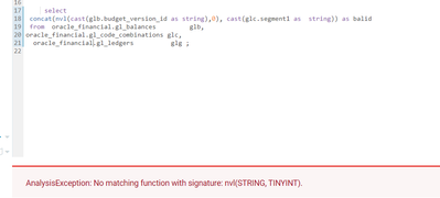

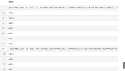

If I add a null to a value, null will be returned.
I tried NVL it is not working.

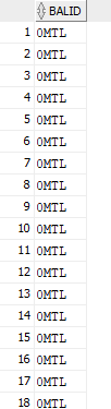

On Oracle below works
select
concat(nvl(cast(glb.budget_version_id as varchar2(10)),0), cast(glc.segment1 as varchar2(10))) as balid
from gl.gl_balances glb,
gl.gl_code_combinations glc,
gl.gl_ledgers glg ;
