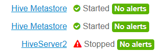

we try to start the hive server on master01 machine as the following:
[root@master01 hive]# su hive
[hive@master01 hive]$ /usr/bin/hive --service hiveserver2
but hive command not print anything and hive server still stop
what are the option to check why hive not start?

I run the command but it stuck for along time , regarding the hive-server.pid we have only the file - ls /var/run/hive/ hive.pid , bytheway hive server is running on master03 machine , but not on master01
