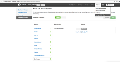

In Ambari 2.5 it is very easy to achieve the Zookeeper or other component auto restart setting from UI itself.
Admin UI --> Admin (Drop Down) --> Service Auto Start
Created 06-23-2017 05:31 AM
yes i set it ,but can't auto start ..
