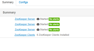

we run the follwing curl in order to check which services/component are in maintenance mode
curl -u admin:admin -H "X-Requested-By: ambari" -X GET http://localhost:8080/api/v1/clusters/sys76/services?ServiceInfo/maintenance_state=OFF
as we can see all zookeeper are in maintenance mode
but the output from API still show - "maintenance_state" : "OFF"
why ? - what its wrong here ?

The is the correct way to check for Maintenance Mode being enabled. Which version of Ambari are you running? When I try this locally, the correct value for `maintenance_state` is reflected.
Also - you're putting the ZooKeeper service itself into MM, right? Putting individual hosts/components into MM won't reflect here.

so in that case can we capture the individual hosts/components that are in MM?

Created 03-21-2018 07:23 PM
Yes, you can - the above calls can capture it on a host/component basis.
