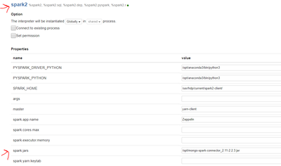

Here is the jar file I added in the Zeppelin interpreter

@chaouki trabelsi mongodb connector is build to leverage spark parallelism. So I think is a good alternative on this case. If you have further questions on how to use it or anything else please open a separate thread! Thanks!
