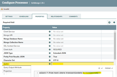

i have  NIFI mongo db connection and need to fetch only new record , i have a long column (transactiondate) (yyyy-MM-dd HH:mm:ss) and need the new transactions in last 1 sec .

thanks for your reply but query in getmongo processor not select statment it's json .
i try query using {"TransactionHistory":"2022-12-21T13:24:34.945+00:00"} as the original  date format but with no result .

this form work in mongo {"transactionDate": {"$gt": ISODate("2021-12-21")}}   but not in nifi
Why does it not work in NiFi? What sort of an error message do you receive? NiFi basically executes what you set in the query property. If you can execute it in mongo, it should work from NiFi as well.
it give an error due to (ISODate)
can you maybe post the statement you are running in mongo + the result and afterwards the query you execute in NiFi and the entire error message you receive? Right now it seems to be an error regarding the format of the date/query. I am not that familiar with mongoDB but maybe in the meantime somebody with more experience will intervene.
