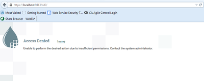

Master Guru
That means the user you are logging in as does not have permission to access the UI. You can check nifi-user.log to see the user identity that is coming from your request (it should be the DN of your cert) and compare that to what is in users.xml and authorizations.xml.
If this is your "initial admin" identity then this should have been entered in authorizers.xml as the initial admin, and that would have granted it all the correct permissions. If you had already tried to setup an initial admin before then you need to delete users.xml and authorizations.xml before trying to change the "initial admin", otherwise it won't take effect.

I am getting this error
Can you please suggest what I should fix ?Thanks
