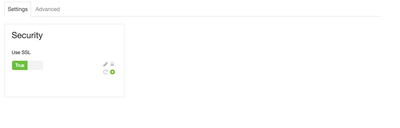

1- check if hive.server2.use.SSL property is set to true on Hive front , 2- make sure the HS2 host certificate(that exists in /etc/security/serverKeys) is copied to cacerts on knox host 3- make sure the knox topology is referring to https://<hiveserver2_host>:<port>;
yes surya it is set to true
