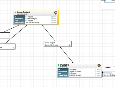

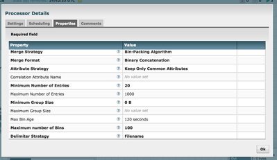

I suggest you aggregate multiple messages into one file before writing to HDFS. This can be done with the MergeContent processor in Nifi. Take a look at the below screenshots showing how it would be set up. Also, take a look at the NiFi Twitter_Dashboard.xml example template (https://raw.githubusercontent.com/abajwa-hw/ambari-nifi-service/master/demofiles/Twitter_Dashboard.x...). You can import this into your NiFi by by clicking on Templates (third icon from right) which will launch the 'Nifi Flow templates' popup, and selecting the file.
