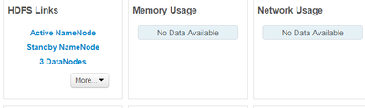

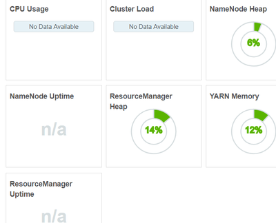

we have ambari cluster , and matrics collector is up but metrics dashboard not display usage ( no data availble ) as the following
