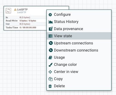

I need to reset the timestamp in my listSFTP in order to re ingest all my files on the remote site, i have been looking for at method to that but have not found it.
I know that the file timestamp is stored somewhere and are used to keep track which files should be listed. I want to start from scrach. Is that possible ?

You need to clear state, this can be done by doing the following:
Right click on the processor, and click "View state"
Then a new window will pop-up,
Then click "Clear state" and then your ListSFTP processor will start fresh.

Thank you very much
