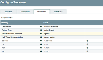

i have recreated same WARN message as you are having with the below Json doc
  "name" : "else",
  "adresse" : "route 66",
  "by" : "Hadoop City" <br>}
with ignore property
This is my json doc to evaljson processor with ignore as path not found property processor wont return any warn messages as it ignore if there is no content for the jsonpath expression.

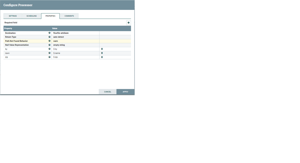

With warn property:-
If you change path not found property to warn processor will return the same warn message as you are having in the question.

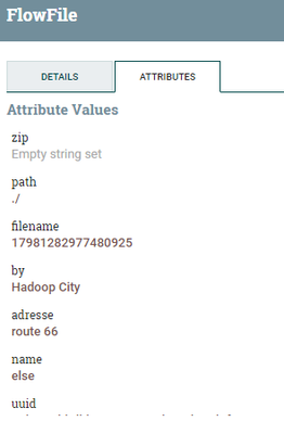

both cases results the same output as zip attribute value is Empty string set and routes to Success relation.
