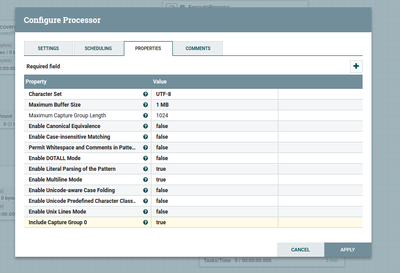

New Member
I can't find where to add regexp patterns here.
Master Mentor
@Gu Gur
You can right click on any NiFi processor and select "usage" to get the complete documentation on that processor. Any processor documentation that states it supports "Dynamic Properties" will allow you to add additional properties in the documented format.
To add an additional property simply click on the following icon on the properties tab:
Thanks,
Matt
Super Collaborator
@Gu Gur And just to add a little detail to Matt's comment, from the documentation,
Regular Expressions are entered by adding user-defined properties; the name of the property maps to the Attribute Name into which the result will be placed.
