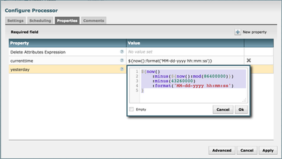

I confirmed this EL statement by using it in an UpdateAttribute processor:
and if I look at the attributes on a FlowFile that was processed by the above, I see:
You can see that the attribute "yesterday" is set to exactly one day earlier from "current time" and 11:59:00.
