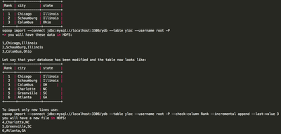

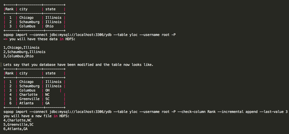

  • Append mode: see point 2. Append import only new lines and not the modified one. This also requires having an incremental ID
Note that row 3 has been modified (Ohio -> Oh). However, it has not been imported in the second import
Hope this helps
