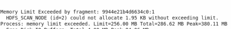

Created 07-12-2017 03:02 PM
Hi,
I am unable to implement your suggestions. Pl can you elaborate. How do i increase memory of my impala daemon from 256 MB. mem_limit at startup did not work. My queries need more memory. My computer has 10GB of Ram overall.

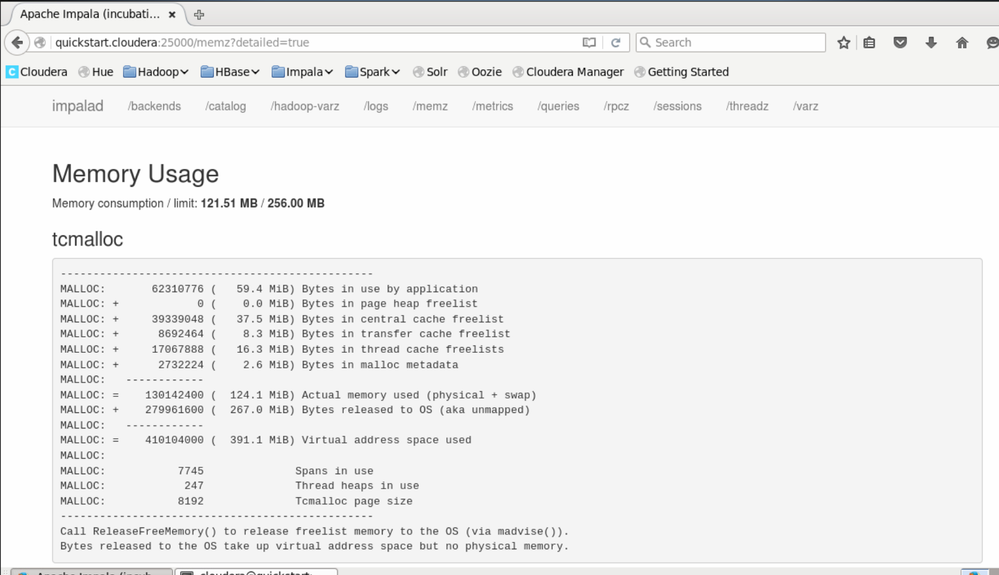

Created 07-12-2017 03:19 PM
@adi91 - How did you set --mem_limit? What value did you pass to it? What did http://hostname:25000/memz?detailed=true say after applying --mem_limit to the command line options? Did your value show up there?

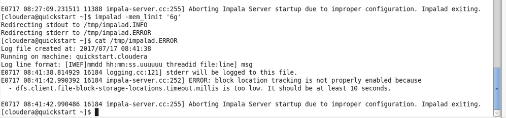

Created 07-17-2017 11:47 AM
Hi @Lars Volker @Tim Armstrong
when I run the impalad- mem_limt to 1gb(6gb etc), I get the error as shown in the image.
