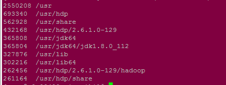

Are you also installing the HDP components on the host where you see /usr mount point is consuming space?
The HDP components also consumes lots of space. According to the HDP installation doc: "A complete installation of HDP 2.6.0 consumes about 6.5 GB of disk space.". As the HDP components and libraries are installed at "/usr/hdp" and "/usr/lib", "/var/lib"
If you want to know what is consuming lots of disk space on "/usr" then in order to find that out we can check the output of the following command to know Ambari/HDP or what else is consuming that much space. It should list top 10 directories consuming more space.
# du -a /usr | sort -n -r | head -n 10

I seen the disk space requirement . I am good with that in other mount point . I have more then 100GB for two mount points .
But the issue with "/usr" , its a default space we get it and cant be extended .
Here is the output of command .
Before install it was "1.5 G" in that mount point . I was not fail at first attempt for that node .
