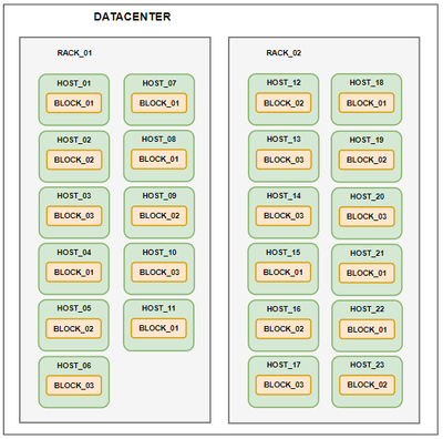

so, by my understanding;
if I separate the datanodes in the two physical racks, as shown in the image below, the blocks will be replicated to all datanodes in the two racks, right?
with that, if rack_01 goes down, I won't have any data loss, right?
Super Collaborator
hi @yagoaparecidoti Yes, the Block for the file would be present on the Datanode in either of the rack. So if you write a file with RF 3, 1 block will be present on a rack and its 2 replicas will be present on different Datanodes of 2nd rack.
