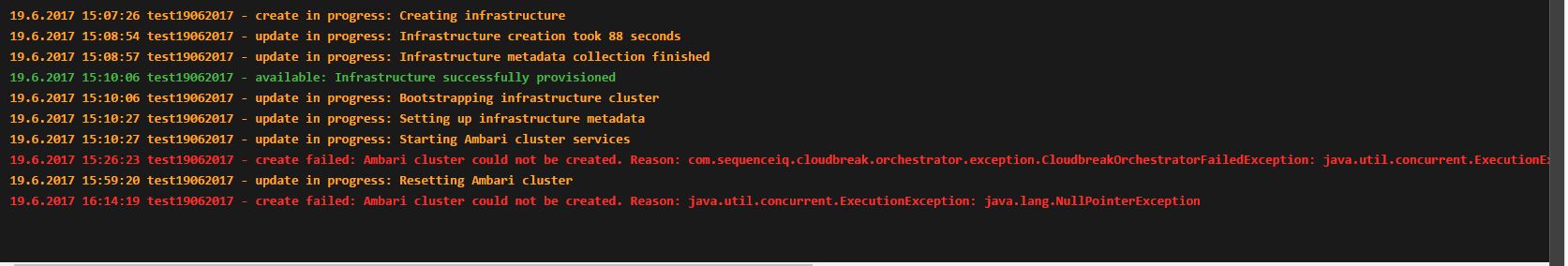

Following is a screenshot of the error.
Following is a screenshot of the error in the event history:error2.jpg

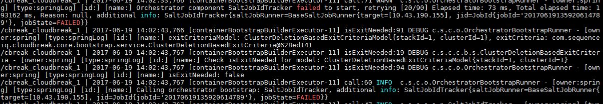

@Chokri Ben Necib What kind of recipes (pre/post) would you like to run? Could you please send us the exception itself? It should be in cloudbreak log if you type:
cbd logs cloudbreak
it is a PRE recipe. It should set Proxy for Internet connection. in Attatchement you find also a section of the log.

Then please share all Cloudbreak logs, because it is difficult to tell what went wrong otherwise.
