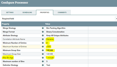

@Hadoop User, Merge content minimum group size depends on your input file size,
In merge content processor
Change Correlation Attribute Name property to
filename //it will binned all the chunks of files that having same filename and merges them.
<strong>Minimum Number of Entries</strong> //this is minimum number of flowfiles to include in a bundle and needs to be at least equal to chunk of files that you are getting after split text processor.
Maximum Number of Entries max number of flowfiles to include in bundle.
<strong>Minimum Group Size minimum size of the bundle</strong>// this should be at least your file size, if not then some of your data will not be merged.
Max Bin Age The maximum age of a Bin that will trigger a Bin to be complete. i.e after those many minutes processor flushes out what ever the flowfiles are waiting before the processor.
in above screenshot i am having Correlation attribute name property as filename that means all the chunks of files that are having same filename will be grouped as one.
Processor waits for minimum 2 files to merge and max is 1000 files and check for min and max group size properties also. if your flow is satisfying these properties then merge content processor won't having any files waiting before merge content processor.
if your flow is not met the configurations above then we need to use Max Bin Age property to flush out all the files that are waiting before the processor.
as you can see in my conf i have given 1 minute so this processor will wait for 1 minute if it won't find any correlation attributes that will flushes out, in your case you need to define the value as per your requirements.
