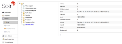

you can also verify it through Solr web UI.
Explorer
Thank you for your answer. I restart the solr and the configuration file appears. I think it may be caused by a mis-configuration days before I get the cluster.
