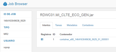

Can you please check the application log of "job_1464163049638_0629" if there are any errors?
Also, resource manager log to understand if the containers are allocated or not.

Hi @Roberto Sancho. Any relevant information in ressources manager logs?

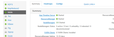

Seems like connectivity issue for Application timeline server, please check if timeline server is up and running.
Created on ‎06-07-2016 11:47 AM - edited ‎08-19-2019 03:07 AM
- Mark as New
- Bookmark
- Subscribe
- Mute
- Subscribe to RSS Feed
- Permalink
Hi: app time is up and here the log
