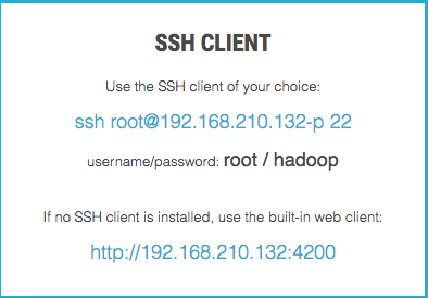

I am using VM ware Sandbox image for my practice. I got the following quick quick links for ssh connection.
When I tried both the clients, both are showing different information. Only the webclient asked me to change the password but not my mac terminal client. Below are the screen shots.

@Raj Kumar
The pictures are not working for me, so I am answering based on an assumption that we see commonly. There are two layers on the HDP Sandbox (Docker and the VM). When using an SSH client, be sure to double check that you are using port 2222 for the Sandbox, and port 2122 if you need to access the Docker side (normally not needed unless you are adding ports).
