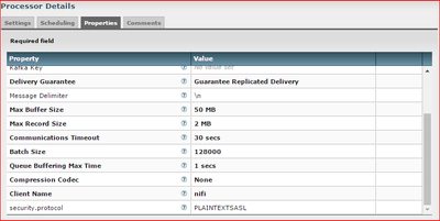

The PutKafka processor looks like:

@Gerd Koenig
Can you try changing the value you have for "Message Delimiter" from "\n" to an actual new line in your PutKafka processor?
You can add a new line by holding the Shift key while hitting enter.
The result will appear as below:
Thanks,
Matt
