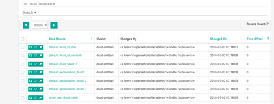

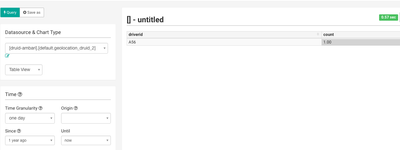

When a Hive external table is created, then the Hive table would be pointing to existing Druid data source and Superset can to viewed from Druid datasource and queried upon.
