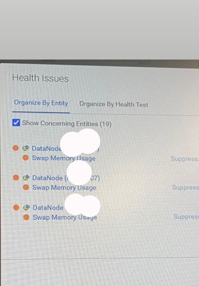

Could you please confirm what services are giving a swap warning? If possible please attach a screenshot to further understand the issue
Explorer
Hello @upadhyayk04 ,
All the services affected except Hue ,hive, hive on Tez , Yarn (MR2 included) and Nifi
please find attached screenshot.
