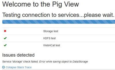

I am getting pretty much the same error message. In my scenario, I recently upgraded from Ambari 2.1 to 2.2.2. I was getting other errors in the Hive and Pig views that I found articles suggesting they were fixed in Ambari 2.2 or later.
The Hive view is working fine now, but the Pig view returns this error in the Ambari-server.log when you click on the Pig view.
Here's a screenshot of the Pig View:
Below is as much of the stack trace as I could fit.
       Service 'storage' check failed:
org.apache.ambari.view.PersistenceException: Caught exception trying to store view entity org.apache.ambari.view.pig.persistence.SmokeTestEntity@65794478

Caused by: org.apache.ambari.view.PersistenceException: The class org.apache.ambari.view.pig.persistence.SmokeTestEntityis not registered as an entity.
