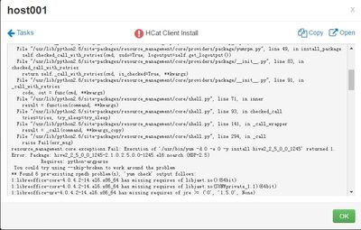

I am in the deployment of HDP2.5 cluster, other services are installed properly, but the installation hive failed, error reporting lack python-argparse, but I manually install argparse, still at the same mistake, I want to know why? Thank you! I am very eager to know where is the problem?

@Ayub PathanThank you for your attention, I have installed argparse, the following picture is specific information

@Ashnee SharmaI never did not install or upgrade python!Can you describe the specific steps?Thank you !
@li michael
Are you have internet on your machine, then only need to execute the command
yum update python*
If you dont have then you need to configure local cent os repo.
New Member
@Ashnee SharmaThank you very much. The problem is solved. I upgraded the python according to your method. I feel so excited! But I am confused, why does this problem appear?Is the official not taking into account this problem?
